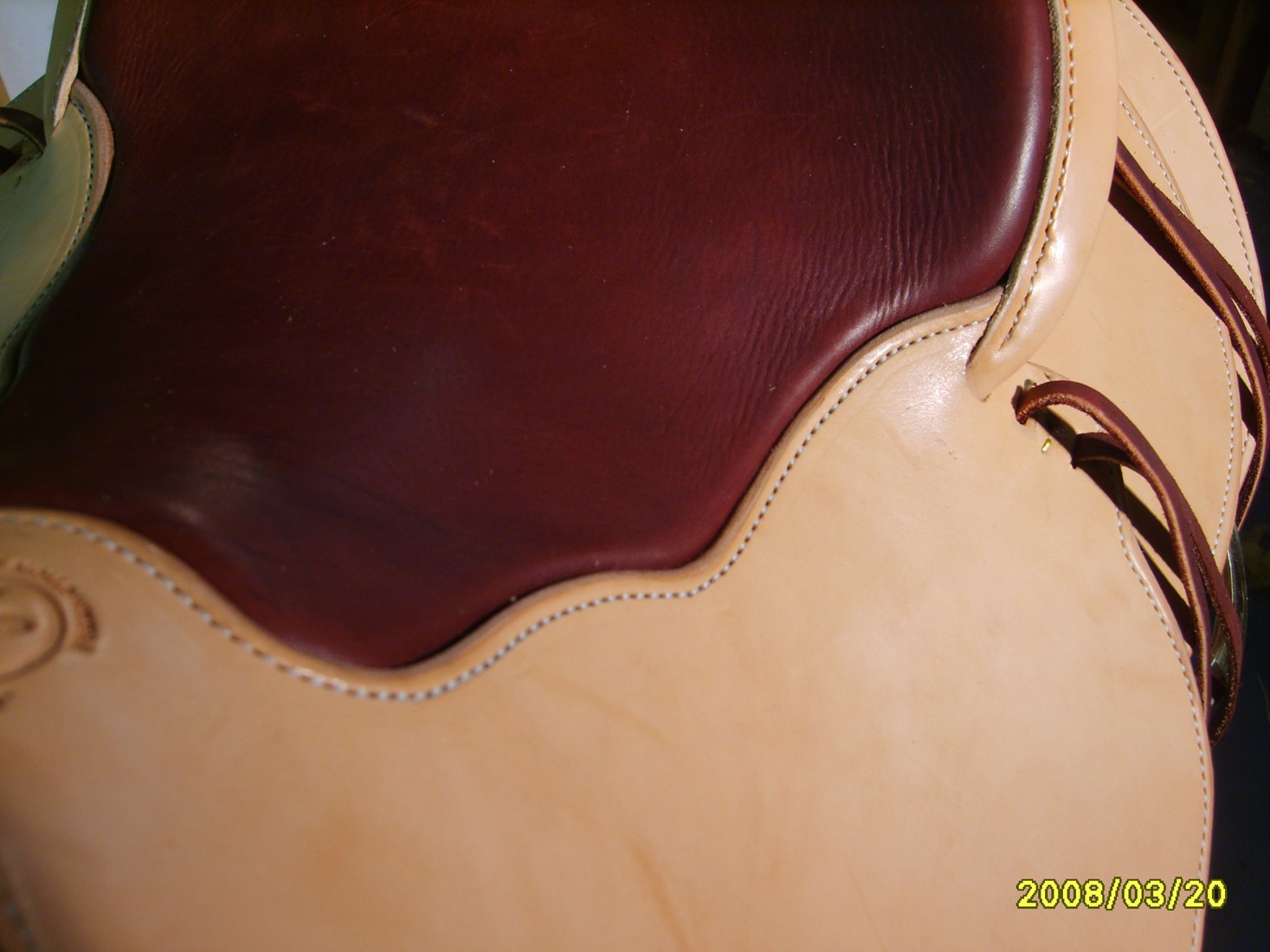

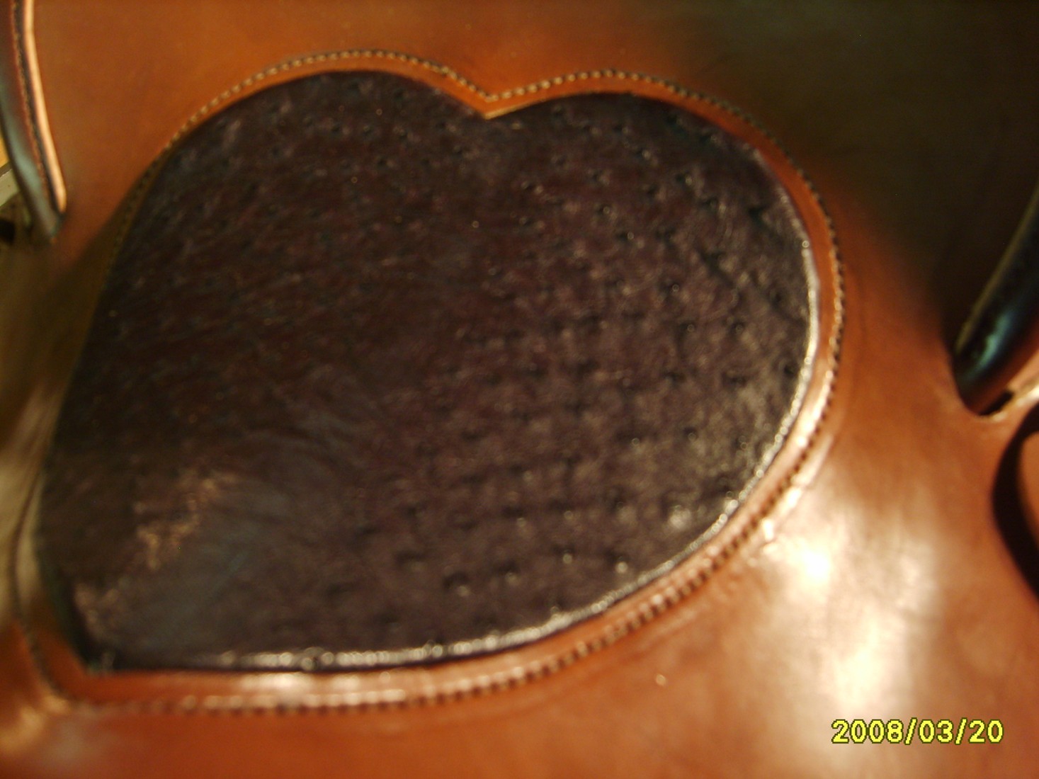

Members greg gomersall Posted March 19, 2008 Members Report Posted March 19, 2008 The bulk of my inlays are done in water buffalo but I have also used (in decreasing order of popularity) stingray, pigskin, alligator , kangaroo and ostrich. I get my foam from MacMaster-Carr. It is a black quick recovery foam which is available in different thicknesses and in firmness ratings from 1 thru 10. I like my inlays on the firm side so I use an 8. I have used some different foams over the years and found the white and grey foams I had tried packed down over time, so far this stuff seems great. I have even tried a few experiments on it pushing the limits of its recoverabilty to date which it has passed supurbely. After I cut the shape of the inlay out of the skirting I turn the seat over and using a french edger I take a 1/2" wide strip of skirting out along the edge of the seat all the way around the inlay hole the THICKNESS of the inlay leather so that everything will lay flush. I do not use a light piece under the inlay in case of future removal. My toughts on this are even if you skive the edges of this you are still altering the profile of the groundseat you spent hours shaping. I form my inlay, glue it in, sew it, then glue the foam in and glue the entire seat in. Greg Quote
Members RyanCope Posted March 19, 2008 Members Report Posted March 19, 2008 The bulk of my inlays are done in water buffalo but I have also used (in decreasing order of popularity) stingray, pigskin, alligator , kangaroo and ostrich. I get my foam from MacMaster-Carr. It is a black quick recovery foam which is available in different thicknesses and in firmness ratings from 1 thru 10. I like my inlays on the firm side so I use an 8. I have used some different foams over the years and found the white and grey foams I had tried packed down over time, so far this stuff seems great. I have even tried a few experiments on it pushing the limits of its recoverabilty to date which it has passed supurbely.After I cut the shape of the inlay out of the skirting I turn the seat over and using a french edger I take a 1/2" wide strip of skirting out along the edge of the seat all the way around the inlay hole the THICKNESS of the inlay leather so that everything will lay flush. I do not use a light piece under the inlay in case of future removal. My toughts on this are even if you skive the edges of this you are still altering the profile of the groundseat you spent hours shaping. I form my inlay, glue it in, sew it, then glue the foam in and glue the entire seat in. Greg Greg, Do you glue your foam directly to the ground seat? Ryan Cope Quote
